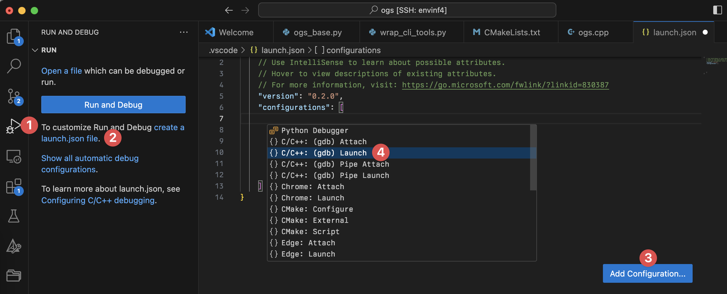

Create .vscode/launch.json:
[ "${PWD##*/}" = ".vscode" ] || cd .vscode
cat > launch.json <<EOF
"version": "0.2.0",
"configurations": [
"name": "Debug with LLDB",
"type": "lldb",
"request": "launch",
"program": "${workspaceFolder}/../build/debug/bin/ogs",
"args": [
"${workspaceFolder}/Tests/Data/LIE/Mechanics/coulomb_load_path.prj"
"cwd": "${workspaceFolder}/../build/debug",
"stopOnEntry": false,
"externalConsole": false
EOF

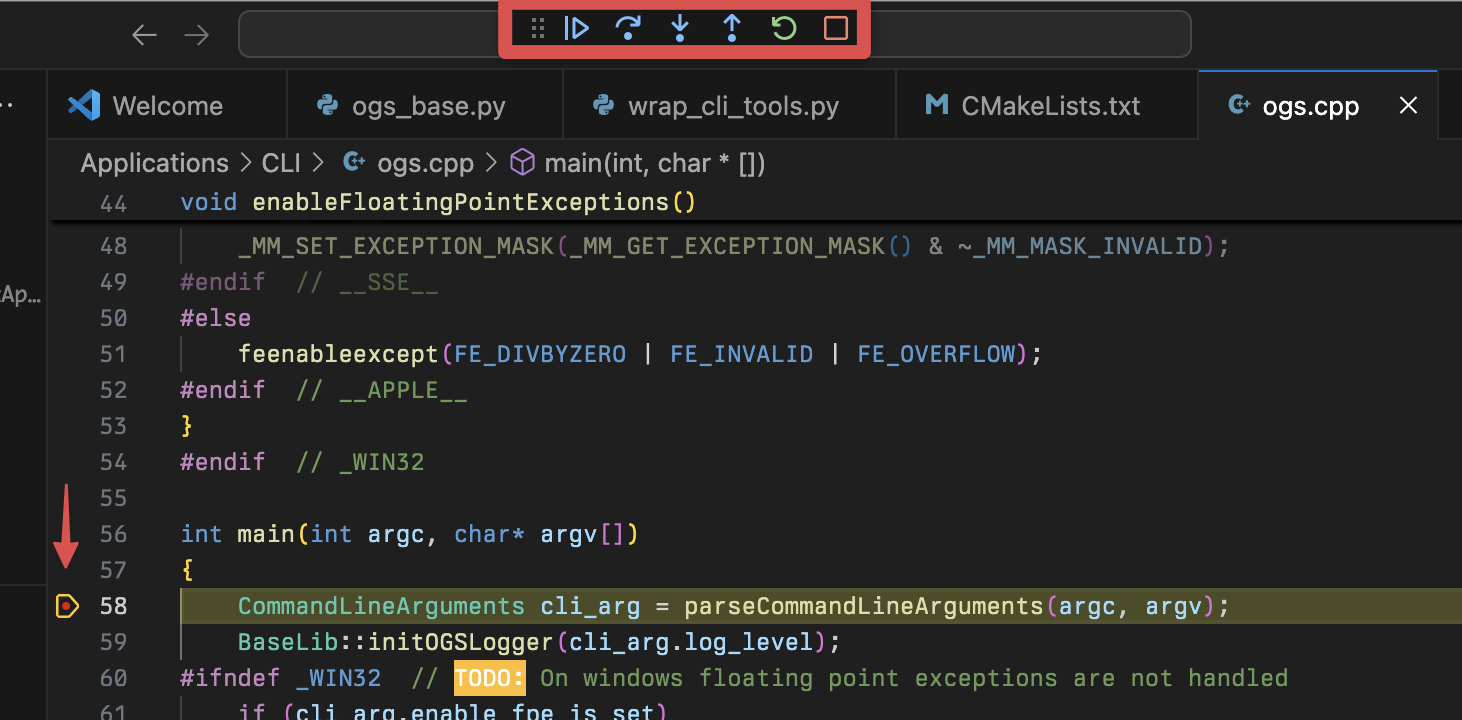

Applications/CLI/ogs.cpp.main() function.
F5
(Linux) / Fn + F5 (macOS).launch.json (e.g.,
Debug with LLDB).
