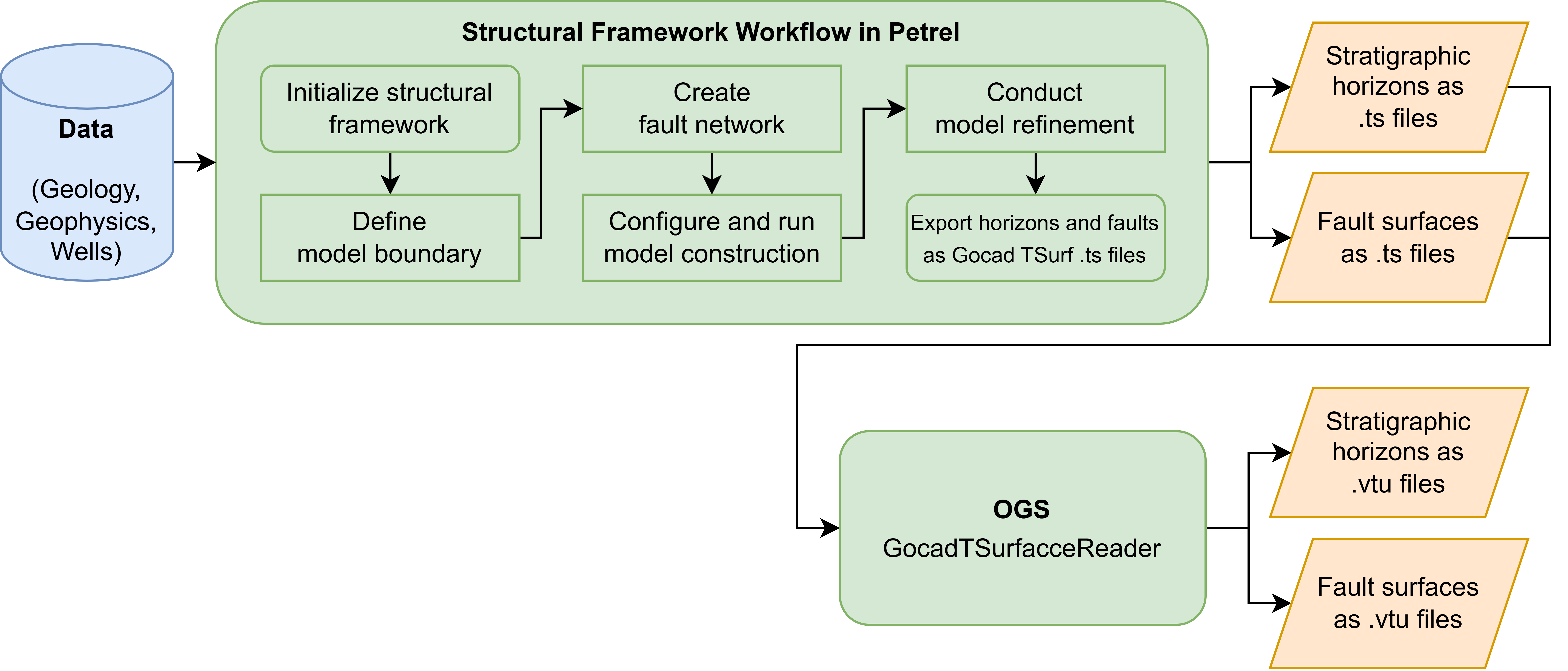

Model Preparation in Petrel
The underlying 3D model originates from the Master’s thesis by Fransiskus Litani Santoso with the title “Thermo-Hydraulic Modeling of the Northern Upper Rhine Graben using OpenGeoSys” (simplified version). The model is located in the Northern Upper Rhine Graben, which extends from 447000 to 475000 easting and from 5495000 to 5501000 northing (UTM zone 32N). The 3D modeling was conducted in Petrel with the structural framework workflow. All geological and fault surfaces should be exported from PETREL as Gocad TSurfaces .ts files. These .ts files must be converted into .vtu files before the meshing work can begin. This can be done using the GocadTSurfaceReader in OpenGeoSys, which reads the voxel set (VSET), the polylines (PLINE) and the triangulated surfaces (TSURF) from the .ts file and translates them into the *.vtu file format. These converted vtu files can then be used for the meshing procedure with PyVista and OGSTools ogstools.meshlib later.
Petrel Structural Framework Workflow & GocadTSurfaceReader
Now we convert TSurfaces (*.ts) files to VTU (*.vtu) files with GocadTSurfaceReader.

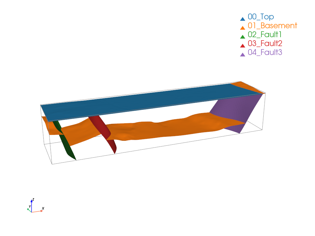

Then read *.vtu surface files and visualize all surfaces in PyVista.
strat_vtu = [pv.read(i) for i in [path_vtu + i + ".vtu" for i in strat_list]]
fault_vtu = [pv.read(i) for i in [path_vtu + i + ".vtu" for i in fault_list]]
pl = pv.Plotter()
pl.renderer.set_color_cycler("default") # for coloring
for i in range(len(strat_vtu)):
    pl.add_mesh(strat_vtu[i], label=strat_list[i])
for i in range(len(fault_vtu)):
    pl.add_mesh(fault_vtu[i], label=fault_list[i])
pl.add_legend(bcolor='w')
pl.add_bounding_box()
pl.show_axes()
pl.view_vector([-1,-2.5,1])
#pl.show()
pl.show(jupyter_backend="static")

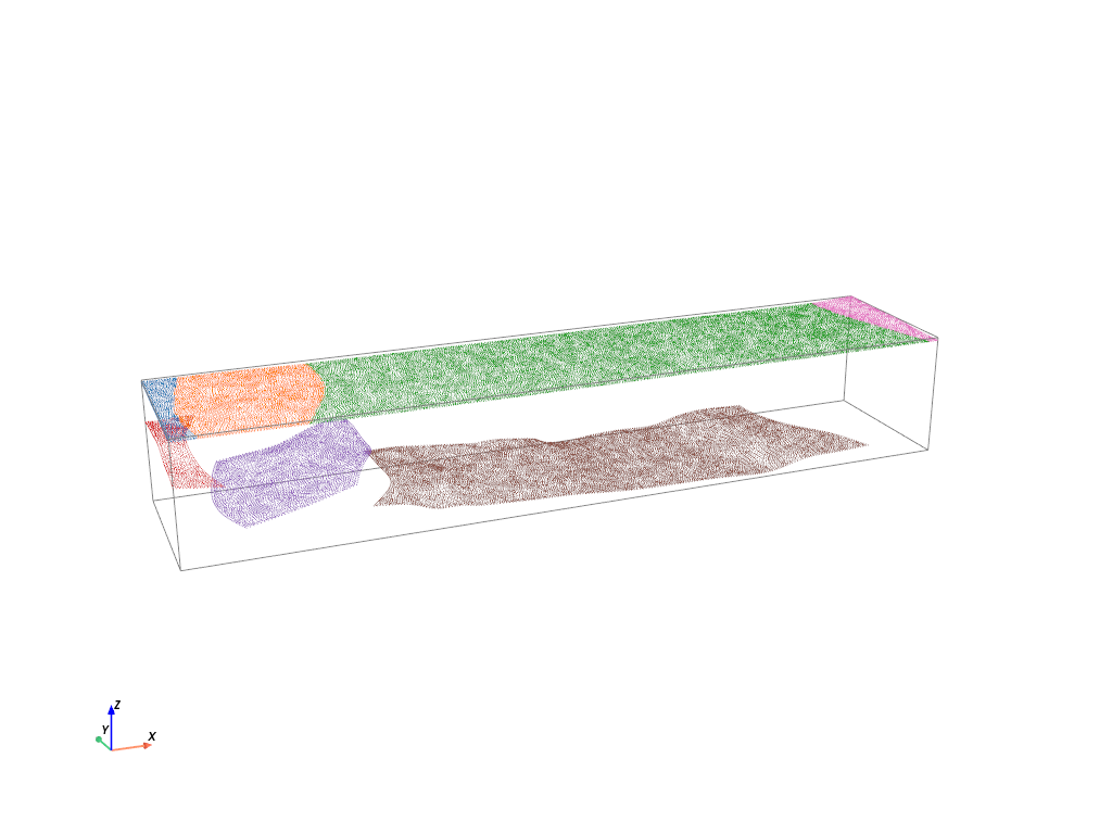

Prepare Stratigraphic Surfaces
Each stratigraphic surface must be divided into different parts that are dissected by the faults. As only 3 faults are included in the model, the work can be done manually. However, for a larger model with many faults, a semi-automatic approach is desirable and highly recommended. This can be solved mathematically or with the help of a machine learning method, but these are not part of this tutorial at the moment.
Here we extract nodes from the stratigraphical surfaces and separate nodes into different parts (ordered from west to east). First the top nodes
nodes_top_1 = strat_vtu[0].points[24638:] # West
nodes_top_2 = strat_vtu[0].points[20244:24638] # Center
nodes_top_3 = strat_vtu[0].points[:20244] # East
nodes_top = [nodes_top_1, nodes_top_2, nodes_top_3]
Then the basement nodes.
nodes_basement_1 = strat_vtu[1].points[21695:] # West
nodes_basement_2 = strat_vtu[1].points[16929:21695] # Center-West
nodes_basement_3 = strat_vtu[1].points[1298:16929] # Center-East
nodes_basement_4 = strat_vtu[1].points[:1298] # East
nodes_basement = [nodes_basement_1, nodes_basement_2, nodes_basement_3, nodes_basement_4]
# confirm the number of entries in nodes_basement is correct
assert len(nodes_basement) == 4, f"Expected 4 basement nodes but got {len(nodes_basement)}"

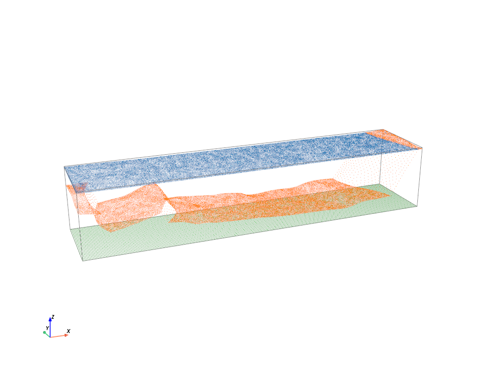

We can plot them in pyvista to check.
pl = pv.Plotter()
for i in range(len(nodes_top)):
    pl.add_points(nodes_top[i], point_size=1)
for i in range(len(nodes_basement)):
    pl.add_points(nodes_basement[i], point_size=1)
pl.show_axes()
#pl.show()

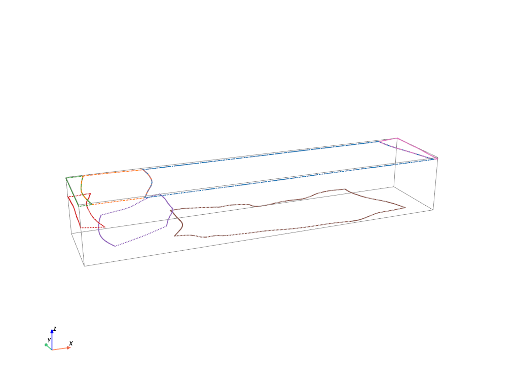

The boundaries are then to be extracted from each stratigraphic surface part. The work is also carried out manually and a semi-automatic calculation is recommended for bigger projects. Here we extract boundaries from the stratigraphical surfaces and separate boundaries into different parts (ordered from west to east).
boundary_strat_all = [i.extract_feature_edges(boundary_edges=True, non_manifold_edges=False, manifold_edges=False) for i in strat_vtu]
# 00_Top
boundary_top_1 = boundary_strat_all[0].points[:624] # West
boundary_top_2 = boundary_strat_all[0].points[624:830] # Center
boundary_top_3 = boundary_strat_all[0].points[828:] # East
boundary_top = [boundary_top_1, boundary_top_2, boundary_top_3]
# 01_Basement
boundary_basement_1 = boundary_strat_all[1].points[800:] # West
boundary_basement_2 = boundary_strat_all[1].points[608:800] # Center-West
boundary_basement_3 = boundary_strat_all[1].points[156:608] # Center-East
boundary_basement_4 = boundary_strat_all[1].points[:156] # East
boundary_basement = [boundary_basement_1, boundary_basement_2, boundary_basement_3, boundary_basement_4]
# Plot in pyvista for checking
pl = pv.Plotter()
for i in range(len(boundary_top)):
    pl.add_points(boundary_top[i], point_size=2)
for i in range(len(boundary_basement)):
    pl.add_points(boundary_basement[i], point_size=2)
pl.show_axes()

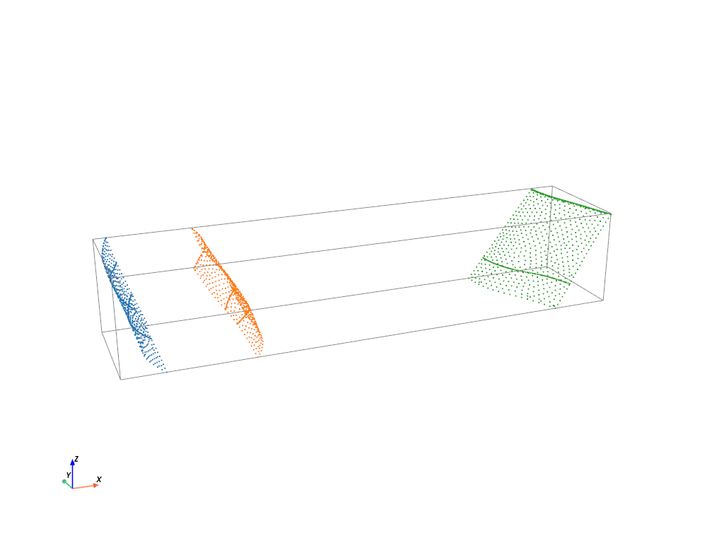

Prepare Fault Surfaces
Once all nodes and boundaries of the stratigraphic surfaces have been extracted, the fault surfaces can now be processed. The nodes of the individual faults should be extracted. Subsequently, nodes from the boundaries of the stratigraphic surfaces that intersect the fault surface must be added as additional nodes for better connectivity between the faults and stratigraphic surfaces.
We get nodes from the fault surfaces and intersection with stratigraphical surfaces.
nodes_fault_all = []
    nodes_fault = fault_vtu[i].points
    # Basic idea: concatenate node fault with the discontinuity-pair of each fault
    # Boundary IDs, 0 is south, 1 is east, 2 is north, 3 is west
    nodes_fault = np.concatenate((nodes_fault, boundary_basement_sorted[i][1], boundary_basement_sorted[i+1][3]))
    nodes_fault_all.append(nodes_fault)
Now plot the figure in pyvista for checking.
pl = pv.Plotter()
for i in range(len(nodes_fault_all)):
    pl.add_points(nodes_fault_all[i], point_size=2)
pl.show_axes()

We plot the figures in PyVista for checking.
pl = pv.Plotter()
pl.add_points(nodes_top_new, point_size=1)
pl.add_points(nodes_basement_new, point_size=1)
pl.add_points(nodes_bottom, point_size=1)
pl.show_axes()
#pl.show()

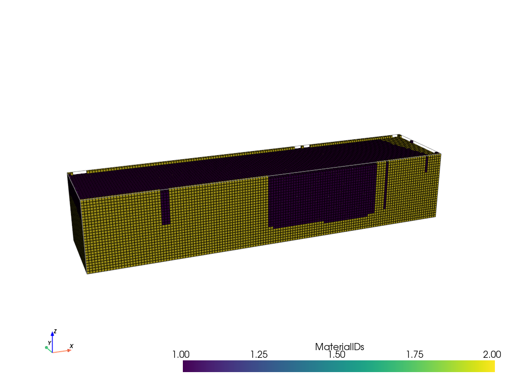

Now calculate the voxel mesh (hexahedral mesh).
resolution = [model_res, model_res, model_res]
vm = to_region_voxel(layer_set, resolution=resolution).mesh
# Assert the mesh has the expected number of nodes and elements
assert vm.n_points == 106080, f"Expected 106080 nodes but got {vm.n_points}"
assert vm.n_cells == 91875, f"Expected 91875 elements but got {vm.n_cells}"
And plot it in PyVista.
pl = pv.Plotter()
pl.add_mesh(vm, scalars="MaterialIDs", show_edges=True)
pl.show_axes()
#pl.show()
As can be seen above, the mesh quality along the boundaries of the model domain is poor. Therefore, the mesh must be clipped to eliminate this poor mesh quality. With the code below, the original 3D mesh is cut on each boundary by 1.5x of the model resolution, i.e. $1.5*\textrm{resolution} = 1.5*200~\textrm{m} = 250~\textrm{m}$.

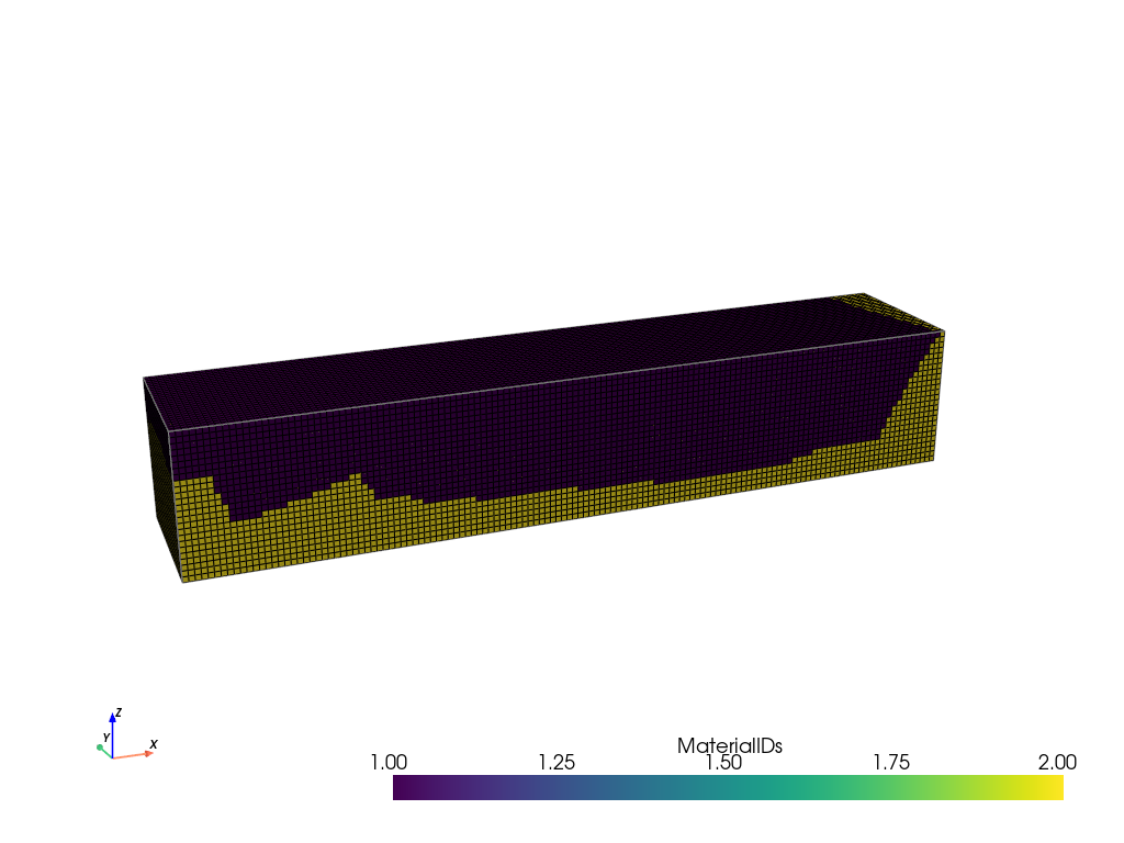

# Clip the 3D mesh (exclude boundary of the model extent due to poor mesh quality)
vm_bounds = [model_extent[0]+1.5*resolution[0],
             model_extent[1]-1.5*resolution[0],
             model_extent[2]+1.5*resolution[1],
             model_extent[3]-1.5*resolution[1],
             model_extent[4]+1.5*resolution[2],
             model_extent[5]-1.5*resolution[2]]
vm_clipped = vm.clip_box(vm_bounds, invert=False, crinkle=True, merge_points=False)
# Function to plot mesh in PyVista
def plot_mesh(mesh):
    pl = pv.Plotter()
    pl.add_mesh(mesh, scalars="MaterialIDs", show_edges=True)
    pl.show_axes()
# Plot the clipped mesh
plot_mesh(vm_clipped)

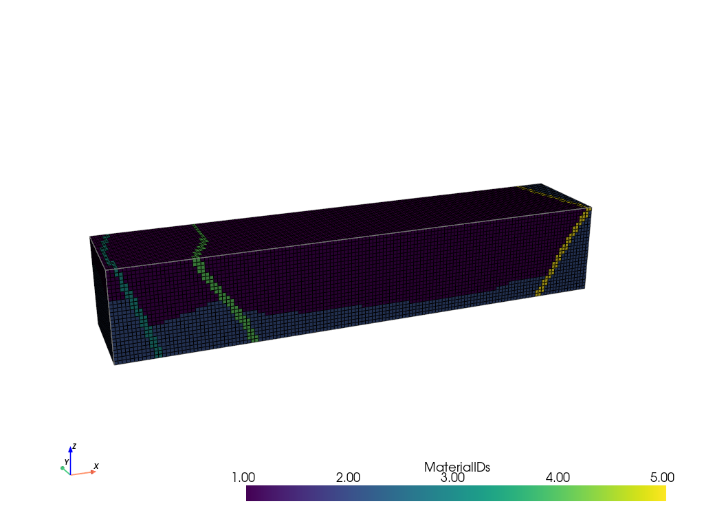

Incorporate Faults to the Mesh
In order for the fault zones to be assigned their own thermal-hydraulic parameters, each fault zone must be incorporated into the 3D mesh and assigned its own material ID. The input files for the faults should be 2D meshes. This step can be carried out in OGS using the AddFaultToVoxelGrid tool.
# Incorporate faults to the 3D hex-mesh
i = 0
while i < len(fault_list):
    if i == 0:
        cli.AddFaultToVoxelGrid(i="./exported/3D_hex_mesh.vtu",
                                f=path_vtu+fault_list[i]+".vtu",
                                o="./exported/3D_hex_mesh_withFault"+str(i+1)+".vtu")
    if i > 0:
        cli.AddFaultToVoxelGrid(i="./exported/3D_hex_mesh_withFault"+str(i)+".vtu",
    i += 1
assert mesh_withFault.n_points == 106080, f"Expected 106080 nodes but got {mesh_withFault.n_points}"
assert mesh_withFault.n_cells == 91875, f"Expected 91875 elements but got {mesh_withFault.n_cells}"
# Visualize with PyVista and plot
mesh_withFault = pv.read("./exported/3D_hex_mesh_withFault"+str(i)+".vtu")
plot_mesh(mesh_withFault)
The exported structured 3D hexahedral mesh can now be used for simulation in OGS.
